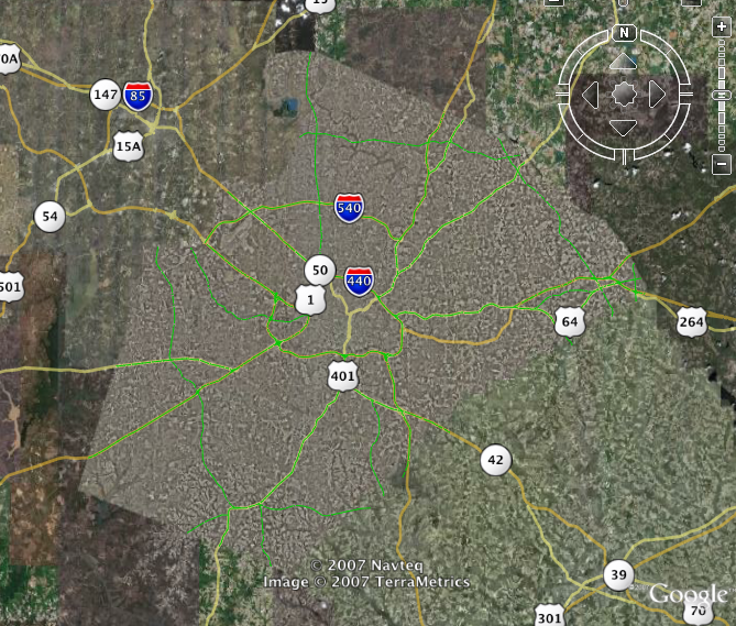

I was looking for that, thanks. I have tested it against the new
nc_spm_05 mapset with both NO success and success (see link below)
and the following error twice
icontransparency=255/Applications/GRASS-6.3.app/Contents/Resources/
scripts/v.out.kml.sh: line 471: ${$THE_OGR_PATH}: bad substitution
First from the popup menu
v.out.kml.sh -l map=roadsmajor at PERMANENT output=/Users/adiez/Desktop/
pruebakmloutgrass.kml color=00:200:00 transparency=255
fcolor=00:100:00 ftransparency=255 size=1 iconcode=1 iconpalette=1
iconcolor=00:200:00 icontransparency=255
/Applications/GRASS-6.3.app/Contents/Resources/scripts/v.out.kml.sh:
Location latlon_location_8464 created!
Input Projection Parameters: +proj=lcc +lat_1=34.33333333333334
+lat_2=36.16666666666666 +lat_0=33.75 +lon_0=-79 +x_0=609601.22
+y_0=0 +no_defs +a=6378137 +rf=298.257222101 +towgs84=0.000,0.000,0.000
Input Unit Factor: 1
Output Projection Parameters: +proj=longlat +no_defs +a=6378137
+rf=298.257223563 +towgs84=0.000,0.000,0.000
Output Unit Factor: 1
Re-projecting vector map...
WARNING: Default driver / database set to:
          driver: dbf
          database: $GISDBASE/$LOCATION_NAME/$MAPSET/dbf/
dbmi: Protocol error
WARNING: Cannot create new table
WARNING: Cannot copy table
Building topology ...
355 primitives registered
Building areas:  100%
0 areas built
0 isles built
Attaching islands:
Attaching centroids:  100%
Topology was built.
Number of nodes     :   266
Number of primitives:   355
Number of points    :   0
Number of lines     :   355
Number of boundaries:   0
Number of centroids :   0
Number of areas     :   0
Number of isles     :   0
ERROR: Could not find input vector map <roadsmajor at PERMANENT>
-f KML /Users/adiez/Desktop/pruebakmloutgrass.kml.raw
roadsmajor at PERMANENT.sh
line 571: FAILURE:: command not found
ERROR:  aborted.
Then from cli, after copying roadsmajor at PERMANENT to roadmajors at
current mapset
v.out.kml.sh -l map=roadsmajorc output=/Users/adiez/Desktop/
iconcolor=00:200:00 icontransparency=255/Applications/GRASS-6.3.app/
Contents/Resources/scripts/v.out.kml.sh: line 471: ${$THE_OGR_PATH}:
bad substitution
Location latlon_location_8938 created!
          driver: dbf
0 areas built
0 isles built
Attaching islands:
Topology was built.
Number of areas     :   0
Number of isles     :   0
Exporting 355 points/lines...
100%
355 features written
-f KML /Users/adiez/Desktop/pruebakmloutgrass.kml.raw roadsmajorc.sh
See for results, in green grass kml
http://www.uv.es/adiez/images/grassoutkml.png
