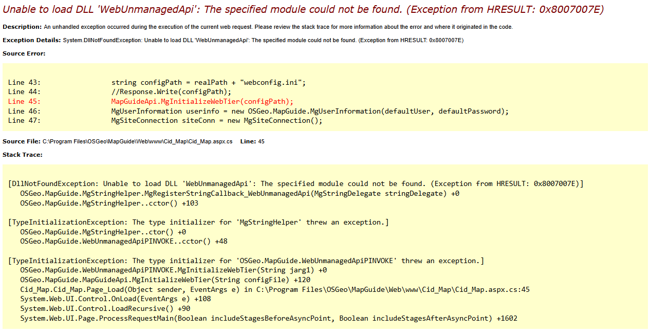

After additional research it appears that WebUnmanagedApi.dll can’t be
found.  The file is in my project. I double checked all the Mapguide
references added with Nuget, versions are all v4.0.30319.  VS Platform
target is x64 and target framework is .NET Framework 4.8. MapGuide Server
(Version 4.0.0.10202).  Windows 11
Here are the references in my project:
Here is the error message:

Instead of MgSite, I usually use MgSiteConnection..
 Dim siteConnection As MgSiteConnection = New MgSiteConnection()
siteConnection.Open(userInfo)
(sorry vb example)
