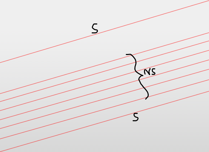

Definitely spatial index, and coordinate system can effect this. Using
views instead of tables can do this.
I found an odd ball outlier that if you make fields displayable in maestro
and any have a null value for the checked fields it will fail. I documented
this in git. I just unchecked all fields and selections worked again (I
don't use the built in viewer)

> The other issue is that the underlying spatial table or view does not have
> a primary key.

>> We're experiencing an issue where random items on the map won't select,
>> even though the layer is set to be selectable. I've been unable to identify
>> a common setting between the various layers that are experiencing this
>> issue.
>> In the below image, the outermost lines are selectable (labelled as “S”),
>> however the inner ones are not selectable (labelled as “NS”), unless you
>> also select one of the outer lines. We're getting similar behaviour in
>> other layers that correspond to different tables.
>> Has anyone else encountered this issue? We're using MGOS 4 Final Release.
