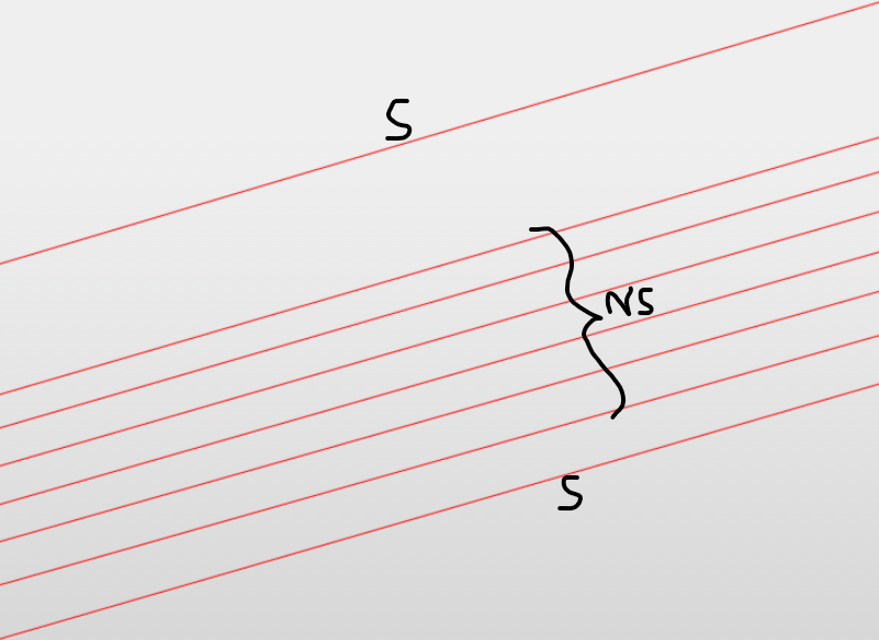

Thanks everyone for your suggestions. Based on the feedback, we identified
the issue being Nulls in a Date formatted field in the database table. On
our install, there doesn't appear to be an issue with Nulls present in
fields formatted differently.

> I suspect that it is because it is a numeric value that contains null, and
> there is a bug in the function that returns value in MapGuide that causes
> null value to give an error. Is there probably information about this in
> the log file for MapGuide? Kind regards, Dan

> We're experiencing an issue where random items on the map won't select,
> even though the layer is set to be selectable. I've been unable to identify
> a common setting between the various layers that are experiencing this
> issue.
> In the below image, the outermost lines are selectable (labelled as “S”),
> however the inner ones are not selectable (labelled as “NS”), unless you
> also select one of the outer lines. We're getting similar behaviour in
> other layers that correspond to different tables.
> Has anyone else encountered this issue? We're using MGOS 4 Final Release.
> We don’t encounter this issue in an environment that’s set up with MGOS 4
> Beta 2, reading from the same database. Additionally, I'm not noticing any
> entries in the error logs that would point to the issue.
