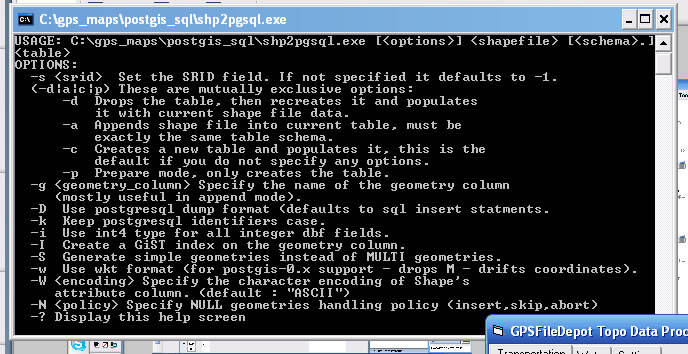

The redirect may not work when running it from Run... or exec inside a
program. This sort of argues for a -f option to write out to file
without needing a stdout redirect.

> I am trying to run shp2pgsql.exe from inside a visual basic program I am
> writing.  Its not working so i tested the command I am sending from the
> "Run" dialog box in windows and it doesn't work.  The dos box pops up and
> goes away too fast but here is what I caught:
> http://www.gpsfiledepot.com/shp2pgsql.jpg
> The command I am trying to run is:
> "C:\gps_maps\postgis_sql\shp2pgsql.exe"
> "C:\gps_maps\mississippi_topo\transportation\all_lines.shp" all_lines >
> "C:\gps_maps\mississippi_topo\transportation\all_lines.sql"
> If I run the command when the dos prompt is open it works. Ideas/help would
> be much appreciated.
> Thanks in advance
> Dan
