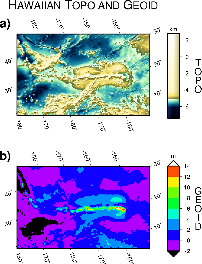

I have gridded data for ocean/lake(that gives depth of water at equidistant
intervals) and I am trying to extract polygon and multipolygons that
represent different water depth range.
example of gridded data set is  here
<http://www.gebco.net/data_and_products/gridded_bathymetry_data/> , and the
polygons  I am trying to create are ST_Multipolygon approximation of
different color areas in this image
<https://www.soest.hawaii.edu/gmt/gmt/html/images/example_02.png>.
