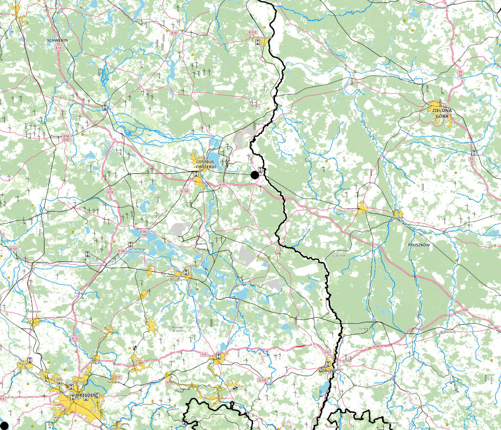

Can you suggest me a way?

I try to explain again what I need...
I created an image, putting more tiles together. This is a PNG.
Then I try to add some markers (airports) at known coordinates. And I
need to convert this coordinates in X,Y related to my image.
I searched many procedures in Internet, but they always position the
markers at the wrong place.
I tried now a very simple procedure that assumes Earth is flat, but it
does not work correctly, too...
This is my code (PHP):
function latlngToScreenXY($lat, $lng, $minLat, $minLng, $maxLat,
$maxLng, $mapWidth, $mapHeight)
   $lngDelta = $maxLng - $minLng;
   $relLng = $lng - $minLng;
   $percLng = $relLng / $lngDelta;
   $x = $mapWidth * $percLng;
   $latDelta = $maxLat - $minLat;
   $relLat = $lat - $minLat;
   $percLat = $relLat / $latDelta;
   $y = $mapWidth * $percLat;
   return array('X' => $x, 'Y' => $mapHeight - $y);
You can see the result as attachment.
In the Map I drawed two circles: the first one at the south-west corner
of the map. This is correct.
The second one should be in the middle of the map ( ($maxLat - $minLat)
/ 2 + $minLat, ($maxLng - $minLng) / 2 + $minLng ), and you see, this is
NOT correct.
Finally I tried to add the markers for the airports of Kamenz and
Bautzen. And they are on the wrong position (both are souther than the
correct position, Kamenz is wester and Bautzen is easter, too).
Can you please send me at least a pseudocode to understand you to
convert LatLng to Y,X of an image?
