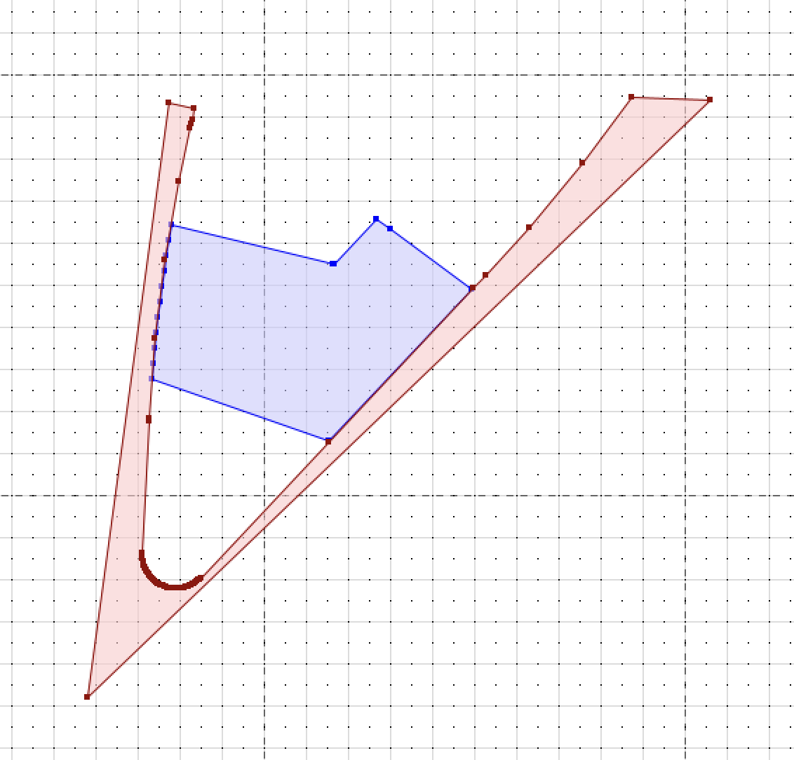

I can confirm reproducing this bug. The shapes are close, but the distance
is non-zero throughout.
Ticketed here.
https://trac.osgeo.org/postgis/ticket/5989
P
[image: Screenshot 2025-09-18 at 10.33.46 AM.png]

> Hi,
> The ST_Distance() query below gives the result of 0 m for the distance
> between two features. The result is wrong as the features are actually
> approximately 0,2 meters away from each other.
> This error is also problematic because Geoserver now uses the
> ST_Distance() function when searching for objects that are touching each
> other, for example.
