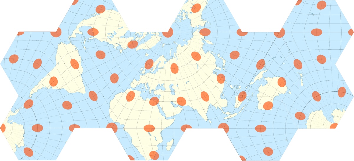

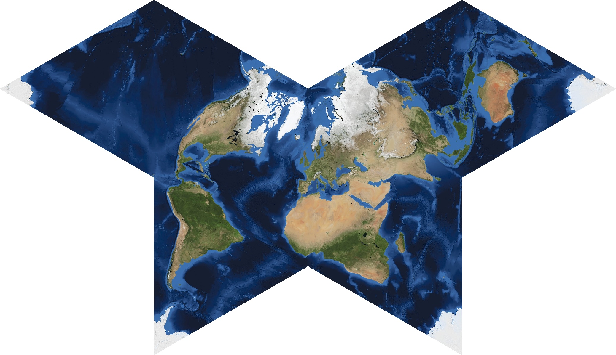

As mentioned in my OP, the CRS isn’t a DGGS. It is a continuous CRS that acts as the backbone for a DGGS.
Consider, please, the net projections that are run using the current system (albeit via the python module).
https://raw.githubusercontent.com/MrBenGriffin/hex9/refs/heads/main/images/rhombus.jpg
Or
https://raw.githubusercontent.com/MrBenGriffin/hex9/refs/heads/main/images/butterfly.jpg
Those are projections under the CRS declared in the OP - they are not representative of a DGGS.
I’m not denying that the CRS is related to (and supports) DGGS - but it is not a DGGS.
The query concerned how best to capture a global coordinate that involves an octahedral scheme - It feels like you picked up on something else.
One of the aspects of this, which to me feels the most obvious, is that a CRS is continuous, while a DGGS is not.
I feel that my position on this is defensible.
