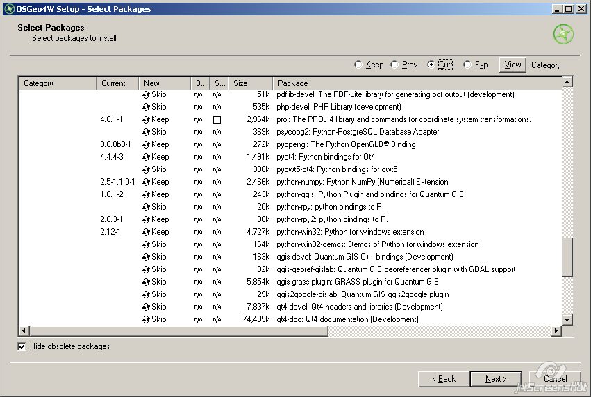

On Mar 29, 2009, at 7:44 PM, Maxim Dubinin wrote:
> Hi Carson,
> great news, I'm using R a lot and the idea of interfacing it with QGIS
> is great.
> I have some problems with making manageR work. Though it seems that
> all the
> components are there (python-rpy2, python-numpy):
> http://gis-lab.info/images/screenshots/20090329-fqt-109kb.jpg
> I'm still getting this error after installing and clicking on manageR
> button
> Traceback (most recent call last):
>  File "C:/Documents and Settings/mdubinin/.qgis//python/plugins
> \manageR\manageR.py", line 28, in run
>    import manageRDialog
> \manageR\manageRDialog.py", line 6, in
>    from QLayerConverter import QVectorLayerConverter,
> QRasterLayerConverter
> \manageR\QLayerConverter.py", line 4, in
>    import Numeric, array
> ImportError: No module named Numeric
