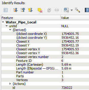

> QGIS reports the geometry type for geometry field geom3d as Geometry Line
> (MultiLineString)
> Identify Results shows no Z values for the geometry:
> [image: image.png]

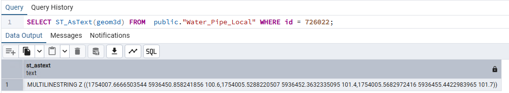

> *The source data* is in PostGIS and is 3D - an example is:
> [image: image.png]
