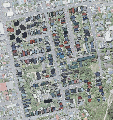

hey Grant
You can take a colour from a raster and apply, this expression goes in the data defined override for the colour of the symbology, it takes the centroid and looks at each band of a raster ('wellington_0075m_urban_aerial_photos_2021_91c5e45d_9ea8_43e1_b49e_a24953a0c0c1', in the example) for the colour
color_rgba(
raster_value( 'wellington_0075m_urban_aerial_photos_2021_91c5e45d_9ea8_43e1_b49e_a24953a0c0c1', 1,  centroid( $geometry )),
raster_value( 'wellington_0075m_urban_aerial_photos_2021_91c5e45d_9ea8_43e1_b49e_a24953a0c0c1', 2, centroid( $geometry )),
raster_value( 'wellington_0075m_urban_aerial_photos_2021_91c5e45d_9ea8_43e1_b49e_a24953a0c0c1', 3, centroid( $geometry )),
255
here its just showing the roof colour
[cid:ebd637a8-2e5e-4db8-a19b-022294644f38]
were you trying to get colour from a raster and apply to a vector symbology?
so you just need to figure out which point you want to apply it to

Hi Grant,
I'm not sure I understand your question, or at least the context in detail.
This depends on how the grid colours are defined in QGIS.
If the grid is of elevation data,  pixel values are elevations (heights/depths) then to get colours applied you must be applying a colour map to the grid which assigns different colours to different elevation values. Applying the same colour map to your vector contours should give the same colours assigned to the same values in the grid.
If you are not already aware of it, QGIS can import colour maps from cpt-city & colour brewer, both of which have a very wide range of predefined colour maps.
Choose "Create new color ramp" in the QGIS layer Symbology->color ramp  properties.
Brent Wood

I would like to apply colours to vector contour lines that would be derived from a coloured grid of the same data. Anyone have any thoughts on how this is best done?
Cheers Grant
