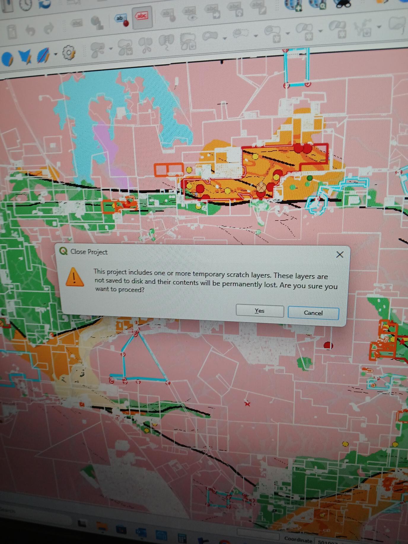

You are saving the file BUT leaving the Temporary Scratch layer. I would
suggest right clicking the temporary layer and using "Make Permanent".
You keep the layer and it's no longer Scratch/Virtual.
Randy
On 11/26/25 5:24 AM, Innocent Komba via QGIS-User wrote:
> Hi QGIS,
> The user attempted to save the files using the ‘Save As’ option. The
> file saves successfully, but when he tries to close the QGIS
> application, this message appears, and if he proceeds, all data is
> lost. "This project includes one or more temporary scratch layers.
> these layers are not saved to disk and their contents will be
> permanently lost. Are you sure you want to proceed"
