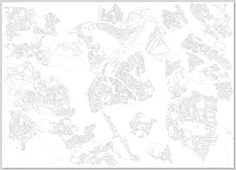

Thank you very much for the second advise.  Without using the styles, yesterday adding themes  allowed me to compose a single layout with several maps.
Here is a snapshot
[Image]
All the best,
Eléonore
