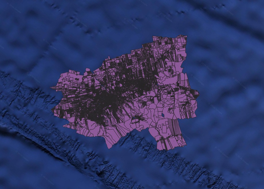

and what I was getting was:
6907586.2790000000968575,3502890.7171762599609792 :
7115309.8435315703973174,3649661.3745090500451624
[image: WhatsApp Image 2026-08-24 at 10.22.53.jpeg]
So I clicked "Ignore Axis Orientation" and "Invert Axis Orientation" and it
worked, it solved the problem for that issue. the source now looks like
this: IgnoreAxisOrientation='1' InvertAxisOrientation='1'
pagingEnabled='default' preferCoordinatesForWfsT11='false'
srsname='EPSG:5345' typename='dgct:parcelas' url='
http://200.49.89.203/geoserver/dgct/wfs' version='auto'
I still can't get it to load completely on this computer but it is at least
looking promising.

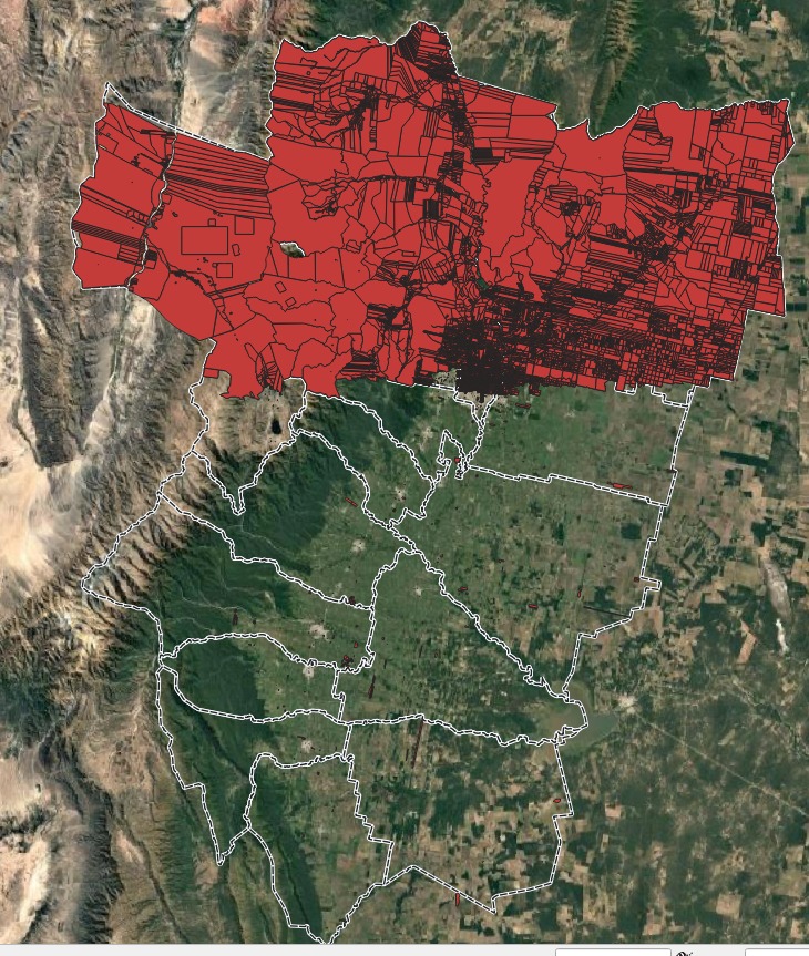

Now without clicking those options it shows the layer like this:
[image: image.png]
and on the source it says this: pagingEnabled='default'
preferCoordinatesForWfsT11='false' srsname='EPSG:5345'
typename='dgct:parcelas' url='http://200.49.89.203/geoserver/dgct/wfs'
version='auto'
not showing any figures whatsoever on the map I'm working on.
