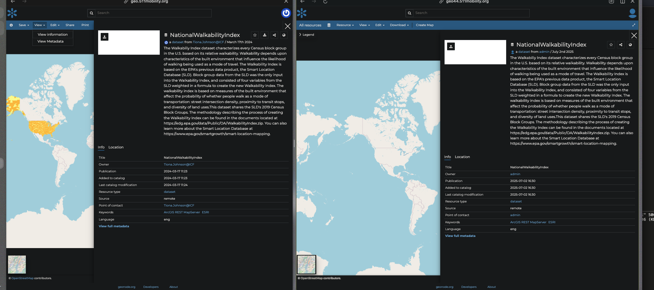

Hi German,
sorry for the long time passed: seems that developers are busy and regular
users have no clue of what'happening, me either.
Did you solved it?
I think that the remote service url should be:
https://geodata.epa.gov/arcgis/rest/services/OA/WalkabilityIndex/MapServer
have you tried to add the service directly from the map without register it?
I have tested inthe in the demo stable and it works in both way.
In my experience the empty image (from wms server) could be related to
wrong coordinates system, youshould find the direct network request in your
browser devloper tools (the proxy is used something like:
https://geodata.epa.gov/arcgis/rest/services/OA/WalkabilityIndex/MapServer/export?F=image&FORMAT=PNG32&TRANSPARENT=true&LAYERS=show%3A0&SIZE=256%2C256&BBOX=-10644926.307106785%2C3757032.814272983%2C-10018754.171394622%2C4383204.9499851465&BBOXSR=3857&IMAGESR=3857&DPI=90
And investigate further.
Have a nice time

> Hi all I am creating a remote service using this URL:
>  https://geodata.epa.gov/arcgis/rest/services/OA/WalkabilityIndex/MapServer/0
> I am importing different services, for example “National Walkability
> Index”, but the map doesn’t show any information (right Image), we
> previously did the same in another instance running Geonode 4.2 and it
> works well (Left image).
> I already added the domain geodata.epa.gov into the property
> PROXY_ALLOWED_HOSTS=['geodata.epa.gov'], I was getting 403 in NGINX
> before adding this property.
> Any idea what is going on?
