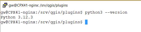

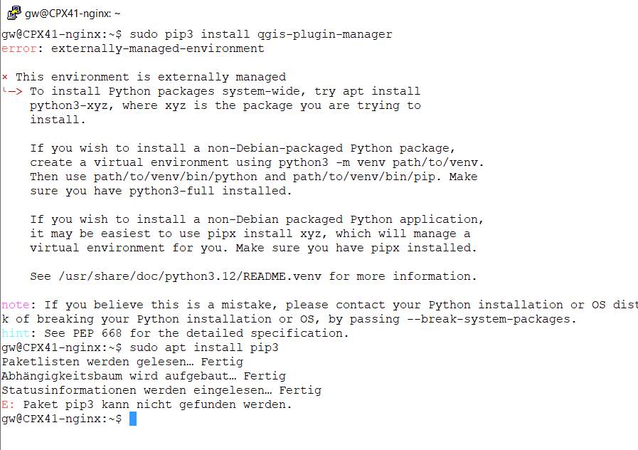

maybe I don't understand/translate it correctly.
But as described at https://pypi.org/project/qgis-plugin-manager/, it doesn't work for me either:
Peter's variant with pipx works or you just do it manually. There is also a good overview of the plugins in the Lizmap backend

Either your pip command is linked to Python2... Maybe you should try pip3 which is linked to Python3.
But I think it's a higher probability that you are running Python 3.13, I just enabled it for the installation of qgis-plugin-manager. It should be fixed now.

Hi Etienne
Late reaction from me. Sorry !
On Ubuntu 24.04 pip is not finding the qgis-plugin-manager for installation.
But with pipx this is working:
# Installation QGIS Plugin Manager
sudo apt install pipx
sudo PIPX_BIN_DIR=/usr/local/bin pipx install qgis-plugin-manager
After this you have re open a new terminal.
cd /srv/qgis/plugins
qgis-plugin-manager init
qgis-plugin-manager update
qgis-plugin-manager list
qgis-plugin-manager install "Lizmap server"
qgis-plugin-manager install atlasprint
qgis-plugin-manager install wfsOutputExtension
qgis-plugin-manager upgrade
