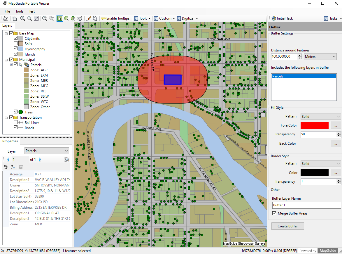

An update on the MapGuide Portable front.
The issue was indeed a missing dll, it just wasn't the dll that I thought
was the missing one.
The missing dll was actually gd.dll (required by
OSGeo.MapGuide.Portable.dll > PortableUnmanagedApi.dll > MgPortable.dll >
MgRenderers.dll > gd.dll) that I forgot to bundle into the nuget package.
This was most apparent when looking under Process Monitor in more detail.
It clearly got lost in the noise when I looked at this problem the first
time round.
Amazing what stepping away from a problem from a few days can do, the
solution sometimes decides to show itself =D
After I added the missing gd.dll, a series of smaller fixable problems
cropped up. These problems were dealt with in short order and now we're
back!
[image: 2025-08-18 23_34_37-MapGuide Portable Viewer.png]
Now that this hurdle's cleared, I'll extend my time allotment on this item
by a few extra days to fix up the rest of the existing code samples before
moving on to the rest of the items I said I'll be taking care of before RC1
will finally drop.
Thank you all for the assistance!
- Jackie
