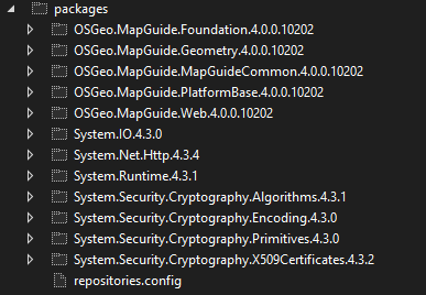

I am still trying to solve the issue below and wondering if anyone on the
list is having similar issues.  There are no errors when building the
project but every Mapguide Api call fails.  I am probably missing something
simple but can’t figure what it might be.  Below is a list of the packages
in my project:

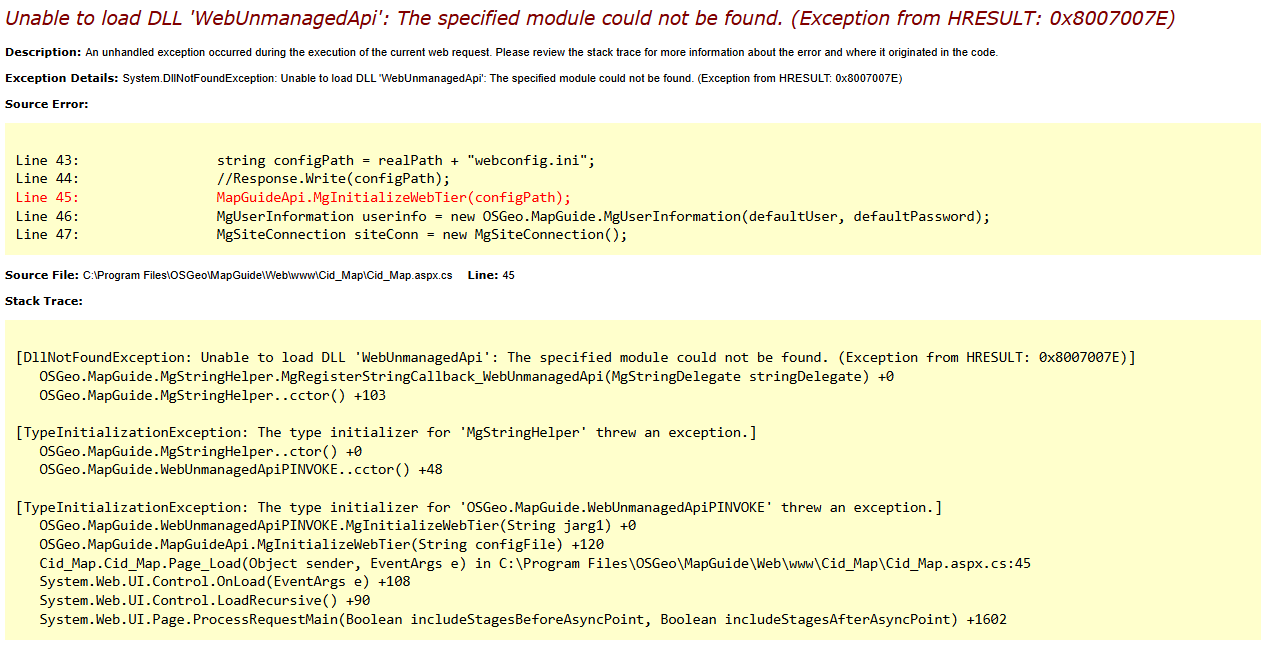

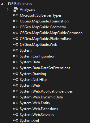

After additional research it appears that WebUnmanagedApi.dll can’t be
found.  The file is in my project. I double checked all the Mapguide
references added with Nuget, versions are all v4.0.30319.  VS Platform
target is x64 and target framework is .NET Framework 4.8. MapGuide Server
(Version 4.0.0.10202).  Windows 11
Here are the references in my project:
Here is the error message:
