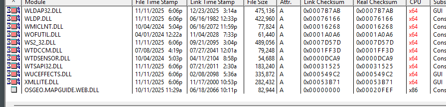

Does anyone know why the bitness of Osgeo.Mapguide.Web.dll shows as x86 in
Dependency Walker?
Sigcheck says the same thing:

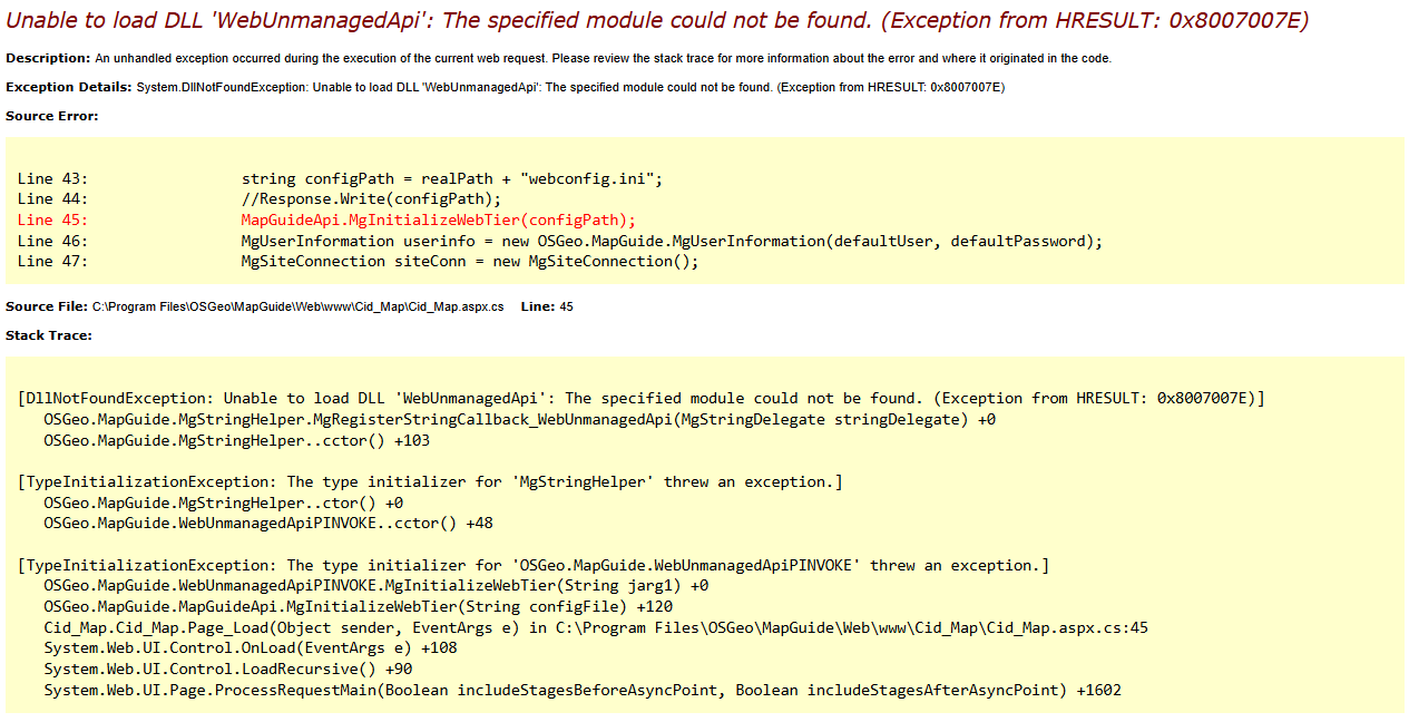

After additional research it appears that WebUnmanagedApi.dll can’t be
found.  The file is in my project. I double checked all the Mapguide
references added with Nuget, versions are all v4.0.30319.  VS Platform
target is x64 and target framework is .NET Framework 4.8. MapGuide Server
(Version 4.0.0.10202).  Windows 11

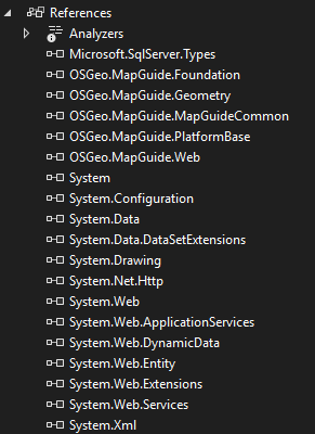

Here are the references in my project:
Here is the error message:

Working on moving a site to MGOS 4 and having trouble creating a session
using this code below which gives the following error:
*The type initializer for 'OSGeo.MapGuide.WebUnmanagedApiPINVOKE' threw an
exception.*
