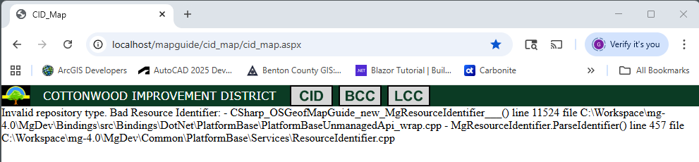

This is just on my local machine so it’s not available for you to try the
url but here is how the layout is embedded in the page.
<frameset id="master" rows="30,*" frameborder="no" framespacing="0">
    <frame name="titleFrame" id="titleFrame" frameborder="0"
marginwidth="0" marginheight="0" scrolling="no" src="title.html">
   <frame name="viewerFrame" id="viewerFrame" frameborder="0"
        src="../mapviewernet/ajaxviewer.aspx?SESSION='<%=sessionId
%>'&WEBLAYOUT='<%=webLayout
%>'&Username=<%=defaultUser%>&Password=<%=defaultPassword%>">
</frameset>
A frame before the layout loads and then the error.  Here is how the page
looks:

I am using  Mapguide 4
.net
IIs 10
Windows 11
and trying to get an old layout with the ajax viewer working.  It’s still
working on a different server with Mapguide 3.1.2.9484.
I have updated my map definition and web layout to the latest resource
versions.
I can preview the layout just fine in Maestro but when I try to load it
into a frame on a web page I get the following error:
Invalid repository type. Bad Resource Identifier: -
CSharp_OSGeofMapGuide_new_MgResourceIdentifier___() line 11524 file
C:\Workspace\mg-4.0\MgDev\Bindings\src\Bindings\DotNet\PlatformBase\PlatformBaseUnmanagedApi_wrap.cpp
- MgResourceIdentifier.ParseIdentifier() line 457 file
C:\Workspace\mg-4.0\MgDev\Common\PlatformBase\Services\ResourceIdentifier.cpp
Does anyone know why I might be getting this error.
