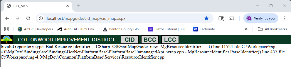

Try removing the single quotes around the WEBLAYOUT.
For example:
http://localhost/mapguide/mapviewernet/ajaxviewer.aspx?weblayout=Library://Samples/Sheboygan/Layouts/SheboyganAsp.WebLayout&LOCALE=en&username=Anonymous&password=
works
but
http://localhost/mapguide/mapviewernet/ajaxviewer.aspx?weblayout='Library://Samples/Sheboygan/Layouts/SheboyganAsp.WebLayout'&LOCALE=en&username=Anonymous&password=
returns the same error you are receiving.

> A frame before the layout loads and then the error.  Here is how the page
> looks:

> I am using  Mapguide 4
> .net
> IIs 10
> Windows 11
> and trying to get an old layout with the ajax viewer working.  It’s still
> working on a different server with Mapguide 3.1.2.9484.
> I have updated my map definition and web layout to the latest resource
> versions.
> I can preview the layout just fine in Maestro but when I try to load it
> into a frame on a web page I get the following error:
> Invalid repository type. Bad Resource Identifier: -
> CSharp_OSGeofMapGuide_new_MgResourceIdentifier___() line 11524 file
> C:\Workspace\mg-4.0\MgDev\Bindings\src\Bindings\DotNet\PlatformBase\PlatformBaseUnmanagedApi_wrap.cpp
> - MgResourceIdentifier.ParseIdentifier() line 457 file
> C:\Workspace\mg-4.0\MgDev\Common\PlatformBase\Services\ResourceIdentifier.cpp
> Does anyone know why I might be getting this error.
