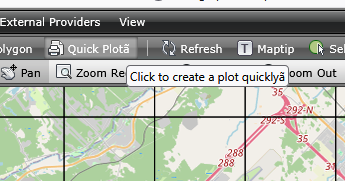

I dit some tests with the widget QuickPlot. I added ã at the end of the
Label and of the Tooltip.
<Label>Quick Plotã </Label>
<Tooltip>Click to create a plot quicklyã </Tooltip>
The results are ok.
It appears that your custom widget is the cause of the problem.
