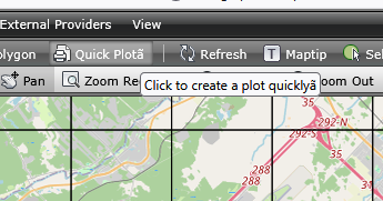

Hi Liglio,
Environment : Windows11, MapGuide 3.1.2.9484, Firefox, Edge, Chrome,
MapGuide Maestro 6.0m12
I dit some tests with the widget QuickPlot. I added ã at the end of the
Label and of the Tooltip.
<Label>Quick Plotã </Label>
<Tooltip>Click to create a plot quicklyã </Tooltip>
The results are ok.
It appears that your custom widget is the cause of the problem.
Regards,
Pierre
