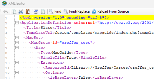

Have you tried to edit the ApplicationDefinition of the XmlEditor to verify if everything looks ok with your custom Widget ?

I tried to use accentuation in a custom Widget at Label or Tooltip but is not working, despite the encoding="utf-8" in XML.
Words like Visão are displayed Vis?o. Maybe the parser it is not applying the right encoding. Can I correct this ?
