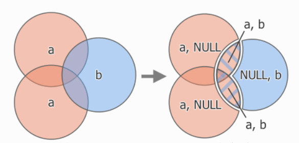

Below a screenshot from the QGIS documentation :
[image: image.png]
My goal would be to have an output file:
   -  Which would be the result of the union/overlay of the 25 input data.
   To use the terms of the QGIS documentation, the processing should check for
   overlaps between features within the 25 layers and create separate features
   for the overlapping and non-overlapping parts. This "multiple union"
   geoprocessing seems interesting for my goal where there is no overlap (a,
   NULL; b, NULL; c, NULL).
   - For areas where there is an overlap, the QGIS union geoprocessing
   creates as many identical overlapping features as there are features
   participating in this overlap. This doesn't bother me. But since,
   ultimately, I'd like a field in the result/output file to allow, for each
   feature, to retrieve the list of input layers that participate/contribute
   to this result feature (in order to retrieve the origin/source of the
   data). I was wondering/thinking it might be better if only one feature was
   created per overlapping area?
