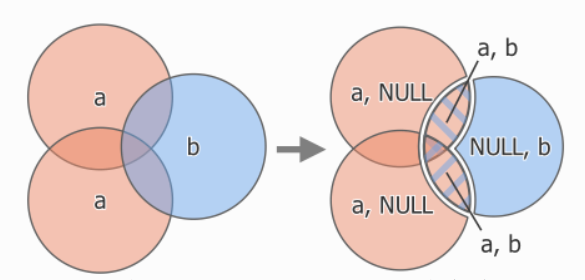

On Mon, Jul 7, 2025 at 1:16 PM celati Laurent <laurent.celati at gmail.com>
wrote:
> Dear all,
> I'm working with QGIS and PostGIS. As input, I have 25 polygonal layers
> covering a large area (multicities area). One of these data is a very large
> dataset (1 million objects). The other 24 are much smaller (a maximum of a
> hundred objects).
> For information, I should point out that some of these polygonal datasets
> are in "multi-part features" mode and others in "single-part features"
> mode. I imagine this may ultimately have a slight impact on the
> method/result. These 25 polygonal .shp files have highly variable,
> non-homogeneous/non-harmonized data structures. Each layer has a "data_id"
> field that allows  to define/link/reference, for each feature, its
> membership in the layer. For example, all values in the "data_id" field for
> the first layer have a value of '1'. For the second layer, the field values
> are '2', etc.
> My goal would be to be able to apply/adapt the existing QGIS geoprocessing
> tool called "Multiple Union":
> https://docs.qgis.org/3.40/en/docs/user_manual/processing_algs/qgis/vectoroverlay.html#union-multiple
> Below a screenshot from the QGIS documentation :
> [image: image.png]
> My goal would be to have an output file:
>    -  Which would be the result of the union/overlay of the 25 input
>    data. To use the terms of the QGIS documentation, the processing should
>    check for overlaps between features within the 25 layers and create
>    separate features for the overlapping and non-overlapping parts. This
>    "multiple union" geoprocessing seems interesting for my goal where there is
>    no overlap (a, NULL; b, NULL; c, NULL).
>    - For areas where there is an overlap, the QGIS union geoprocessing
>    creates as many identical overlapping features as there are features
>    participating in this overlap. This doesn't bother me. But since,
>    ultimately, I'd like a field in the result/output file to allow, for each
>    feature, to retrieve the list of input layers that participate/contribute
>    to this result feature (in order to retrieve the origin/source of the
>    data). I was wondering/thinking it might be better if only one feature was
>    created per overlapping area?
>    -  I'd like a field in the result file to allow, for each feature, to
>    retrieve the list of input layers that participate/contribute to this
>    result feature. In order to retrieve the origin/source of the data.
>    - Ideally, a field that allows you to retrieve the number (COUNT) of
>    layers that contribute to this feature (at least 1 layer, at most 25
>    layers).
>    - Regarding the non-geometric attributes/fields, I would like to be
>    able to specify the selection/define the list of fields I ultimately want
>    to keep. I don't want to keep all of the fields, but rather just some of
>    the fields for each of the 25 input layers.
> I imagine it's recommended to do this processing in PostGIS rather than
> QGIS? I can, if necessary, import my 25 SHP files into a PostGIS database.
> I also imagine it's important to keep in mind that the "multi-part
> features" / "single-part pieces/features" mode of the input layers can
> affect the result. If I'm using a PostGIS query, I was thinking it might be
> helpful to force all features to be in single-part mode (using the PostGIS
> 'st_dump' function?).
> In advance, Thanks so much for your help, guidance.
