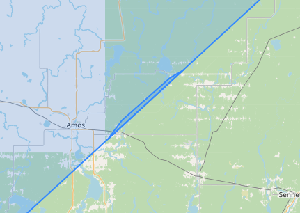

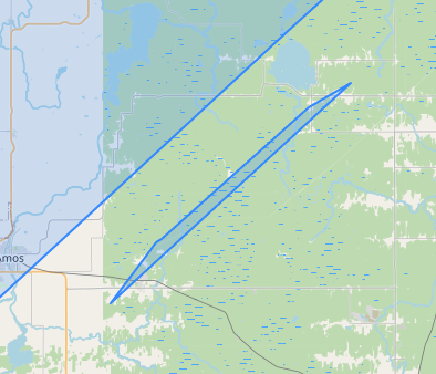

Your smaller polygon is not within the larger one.  If it was then this would return true
SELECT ST_Intersects(ST_GeomFromText('POLYGON((-77.933927810506 48.584377886263184,-77.74471476703403 48.69534746901027,-77.69284285304693 48.71525447165988,-77.99039086603969 48.53485501013662,-77.933927810506 48.584377886263184))', 4326)::geography, ST_GeomFromText('POLYGON((-81.1755551313531 46.64525933571578,-81.50518756520556 47.21802525065504,-81.6706742747649 47.82323694299835,-81.6602226284047 48.438637358868554,-81.46784223247613 49.04081439308046,-81.09452004412593 49.60598066574395,-80.54928811996326 50.110912115887594,-79.84994871352842 50.53403375725974,-79.02318022750863 50.85659915226637,-78.10377843647761 51.06386274945413,-77.13291403765557 51.14610652092342,-76.15549659681517 51.09937193283258,-75.21696581007667 50.925776760111056,-74.42324583717638 50.655006343959805,-81.12758032107652 46.593233077736336,-81.1755551313531 46.64525933571578))',4326)::geography);
And it returns false.  Your ST_Within compare in planar space is invalid as it's treating the surfaces as planar.
If you segmentize your geographies you will see the smaller is not within the larger.
Here is what you get segmentizing in spheroidal space
SELECT ST_Segmentize(ST_GeomFromText('POLYGON((-77.933927810506 48.584377886263184,-77.74471476703403 48.69534746901027,-77.69284285304693 48.71525447165988,-77.99039086603969 48.53485501013662,-77.933927810506 48.584377886263184))', 4326)::geography, 1000)
UNION ALL
SELECT ST_Segmentize(ST_GeomFromText('POLYGON((-81.1755551313531 46.64525933571578,-81.50518756520556 47.21802525065504,-81.6706742747649 47.82323694299835,-81.6602226284047 48.438637358868554,-81.46784223247613 49.04081439308046,-81.09452004412593 49.60598066574395,-80.54928811996326 50.110912115887594,-79.84994871352842 50.53403375725974,-79.02318022750863 50.85659915226637,-78.10377843647761 51.06386274945413,-77.13291403765557 51.14610652092342,-76.15549659681517 51.09937193283258,-75.21696581007667 50.925776760111056,-74.42324583717638 50.655006343959805,-81.12758032107652 46.593233077736336,-81.1755551313531 46.64525933571578))',4326)::geography, 1000);
Here is your planar:
SELECT ST_GeomFromText('POLYGON((-77.933927810506 48.584377886263184,-77.74471476703403 48.69534746901027,-77.69284285304693 48.71525447165988,-77.99039086603969 48.53485501013662,-77.933927810506 48.584377886263184))', 4326)::geography
UNION ALL
SELECT ST_GeomFromText('POLYGON((-81.1755551313531 46.64525933571578,-81.50518756520556 47.21802525065504,-81.6706742747649 47.82323694299835,-81.6602226284047 48.438637358868554,-81.46784223247613 49.04081439308046,-81.09452004412593 49.60598066574395,-80.54928811996326 50.110912115887594,-79.84994871352842 50.53403375725974,-79.02318022750863 50.85659915226637,-78.10377843647761 51.06386274945413,-77.13291403765557 51.14610652092342,-76.15549659681517 51.09937193283258,-75.21696581007667 50.925776760111056,-74.42324583717638 50.655006343959805,-81.12758032107652 46.593233077736336,-81.1755551313531 46.64525933571578))',4326)::geography;
