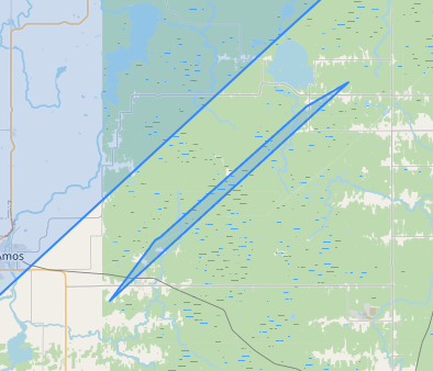

> Your smaller polygon is not within the larger one. If it was then this would return true
> SELECT ST_Intersects(ST_GeomFromText('POLYGON((-77.933927810506 48.584377886263184,-77.74471476703403 48.69534746901027,-77.69284285304693 48.71525447165988,-77.99039086603969 48.53485501013662,-77.933927810506 48.584377886263184))', 4326)::geography, ST_GeomFromText('POLYGON((-81.1755551313531 46.64525933571578,-81.50518756520556 47.21802525065504,-81.6706742747649 47.82323694299835,-81.6602226284047 48.438637358868554,-81.46784223247613 49.04081439308046,-81.09452004412593 49.60598066574395,-80.54928811996326 50.110912115887594,-79.84994871352842 50.53403375725974,-79.02318022750863 50.85659915226637,-78.10377843647761 51.06386274945413,-77.13291403765557 51.14610652092342,-76.15549659681517 51.09937193283258,-75.21696581007667 50.925776760111056,-74.42324583717638 50.655006343959805,-81.12758032107652 46.593233077736336,-81.1755551313531 46.64525933571578))',4326)::geography);
> And it returns false. Your ST_Within compare in planar space is invalid as it's treating the surfaces as planar.
> If you segmentize your geographies you will see the smaller is not within the larger.
> Here is what you get segmentizing in spheroidal space
> SELECT ST_Segmentize(ST_GeomFromText('POLYGON((-77.933927810506 48.584377886263184,-77.74471476703403 48.69534746901027,-77.69284285304693 48.71525447165988,-77.99039086603969 48.53485501013662,-77.933927810506 48.584377886263184))', 4326)::geography, 1000)
> UNION ALL
> SELECT ST_Segmentize(ST_GeomFromText('POLYGON((-81.1755551313531 46.64525933571578,-81.50518756520556 47.21802525065504,-81.6706742747649 47.82323694299835,-81.6602226284047 48.438637358868554,-81.46784223247613 49.04081439308046,-81.09452004412593 49.60598066574395,-80.54928811996326 50.110912115887594,-79.84994871352842 50.53403375725974,-79.02318022750863 50.85659915226637,-78.10377843647761 51.06386274945413,-77.13291403765557 51.14610652092342,-76.15549659681517 51.09937193283258,-75.21696581007667 50.925776760111056,-74.42324583717638 50.655006343959805,-81.12758032107652 46.593233077736336,-81.1755551313531 46.64525933571578))',4326)::geography, 1000);
> Here is your planar:
> SELECT ST_GeomFromText('POLYGON((-77.933927810506 48.584377886263184,-77.74471476703403 48.69534746901027,-77.69284285304693 48.71525447165988,-77.99039086603969 48.53485501013662,-77.933927810506 48.584377886263184))', 4326)::geography
> UNION ALL
> SELECT ST_GeomFromText('POLYGON((-81.1755551313531 46.64525933571578,-81.50518756520556 47.21802525065504,-81.6706742747649 47.82323694299835,-81.6602226284047 48.438637358868554,-81.46784223247613 49.04081439308046,-81.09452004412593 49.60598066574395,-80.54928811996326 50.110912115887594,-79.84994871352842 50.53403375725974,-79.02318022750863 50.85659915226637,-78.10377843647761 51.06386274945413,-77.13291403765557 51.14610652092342,-76.15549659681517 51.09937193283258,-75.21696581007667 50.925776760111056,-74.42324583717638 50.655006343959805,-81.12758032107652 46.593233077736336,-81.1755551313531 46.64525933571578))',4326)::geography;
