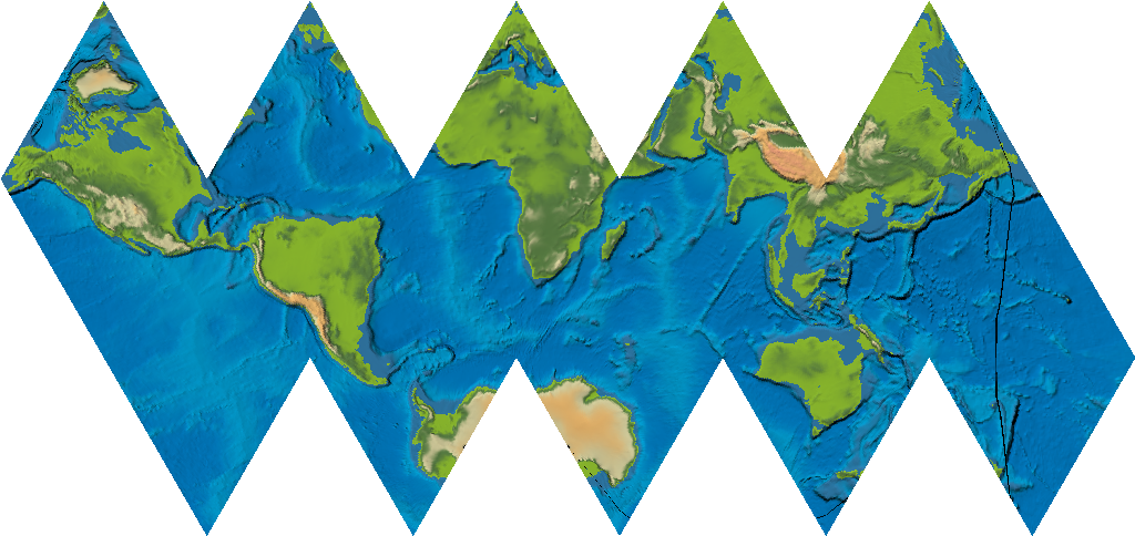

What would make sense to me as the /central longitude & latitude of
origin/ would be which latitude & longitude is projected to the 0, 0
projected coordinates.
This is currently the point at half the height and half the width of the
icosahedron triangle containing South Africa, which is exactly in the
middle of the projection
<https://maps.gnosis.earth/ogcapi/collections/gebco/map?crs=OGC:1534> if
you exclude the bottom-right rhombus (containing part of New Zealand's
north island and Hawaii) making the projection horizontally symmetrical.
I think currently the only way to change this is by specifying false
easting & northing with /+x_0/ and /+y_0/ in projected coordinates.
