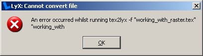

thanks for links! but these editors are not visual ones and will
probably scare off some of our translators ;)
Meanwhile I solved the issue with LyX, turns out it was complaining
about cyrillics in the paths.
Maxim

WM> On Thu, 2009-03-26 at 15:14 -0500, Maxim Dubinin wrote:
>> Hi all,
>> We're thinking about starting translating user guide to Russian, but
>> having some problems with tex. I've tried to install LyX/Miktex, waited
>> for 30 min for it to upload all addons, but only to see it complains
>> on importing any tex-file as Latex (plain):
>> http://gis-lab.info/images/screenshots/20090326-30t-11kb.jpg
>> Any advice on how to solve this? Or may be suggestion on using some
>> other visual editor on Windows? (Yes, we do need visual editor, we want to make
>> participation as easy as possible for everyone who is willing to
>> participate). May be a suggestion how to make life for translators
>> easier, letting them _only_ translate?
>> Thanks.
>> Maxim
