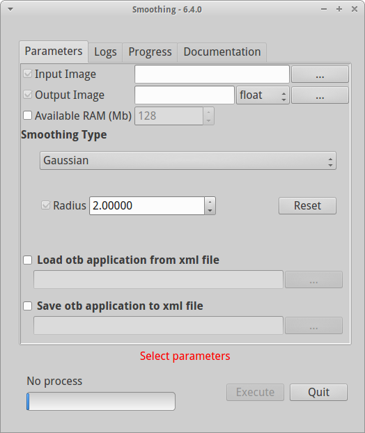

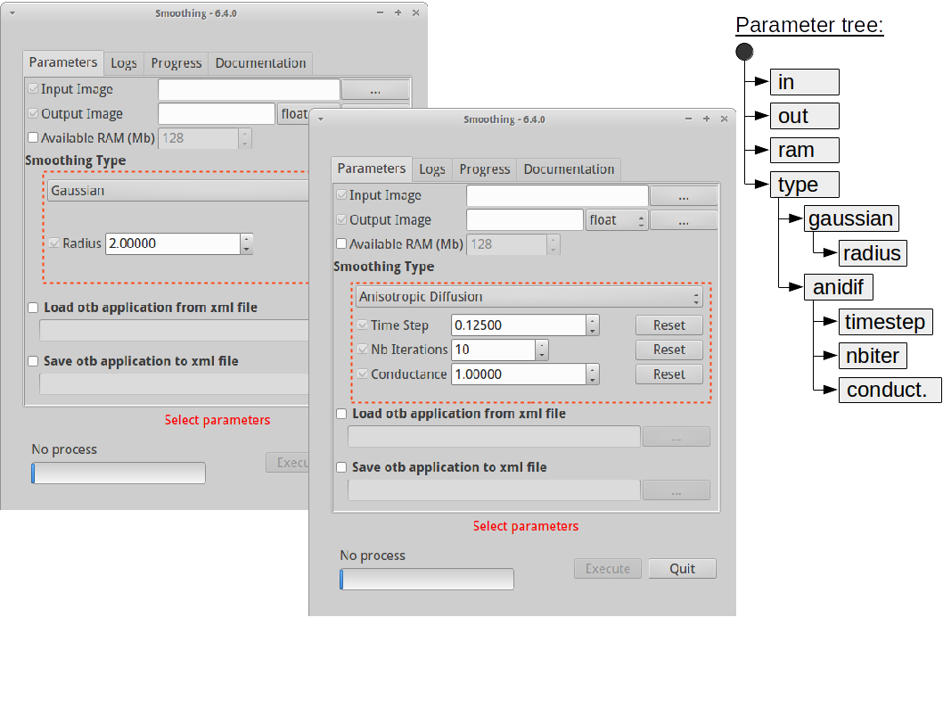

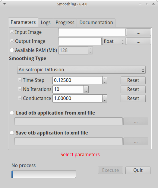

OTB application allows use of parameter with sub parameters,
One such example is here:
https://www.orfeo-toolbox.org/CookBook/Applications/app_Smoo
thing.html#parameters
https://www.orfeo-toolbox.org/CookBook/Applications/app_Trai
nImagesClassifier.html#parameters
There is a parameter called "type" in Smoothing application. "type"
parameter has list of values such as mean, gaussian and anidif.
The ui widget of this parameter is obviously a comboBox.
This flexibility allows users to select which type of smoothing to apply.
Rather than having a three application namely
smoothing_mean, smoothing_gaussian, smoothing_anidif
so parameter type.* (type.mean.radius, type.gaussian.radius, etc..) etc are
child of parameter called "type".
So you can call "type" parameter a group.
A user of application can select -type gaussian -type.gaussian.radius 3
when launching application.
otb application check for invalid cases such as if type is gaussian then
one cannot use -type.mean.radius
This is okay for command line, but for graphical interface one has to hide
/show parameters based on the value of it's parent.
This is a limitation of qgis processing that upstream was forced to split
applications based on group. I am not blaming or targeting here.
Just saying about a missing feature for support for one provider.
 QGIS users now have three application for smoothing and maybe 10 or more
application for TrainImagesClassifer.
This make users of  otb provider as well as developers of both qgis and otb
unhappy.  Perimeter of bug report is getting more and more
And nobody wants to work on this part.
Now, this can be fixed by allowing plugin providers to hide/show any of the
parameters in the ui.
The rule to hide/show can be left out to provider itself.  This change must
go in qgis processing and not in provider plugin.
If qgis processing plugin has a new widget that allows this, then things go
easy.  You can keep providers as external plugin.
But provider will make use a qgs processing ui widget which is already in
tree.  That makes sure it is tested properly among other things.
Provider will be free from hacks such as splitting applications and doing
stuff specific to some version(s)
And this widget can be reused by existing or new providers also.
I am attaching some screenshots from otb application viewer to visual
explanation.
scheme_parameter.png shows the grouping of parameters.
and the other two explains the show/hide of parameters based on value of
parameter "type"
screenshots:
https://www.orfeo-toolbox.org/qgis/schema_parameter.png
https://www.orfeo-toolbox.org/qgis/Screenshot_smoothing_gaussian.png
https://www.orfeo-toolbox.org/qgis/Screenshot_smoothing_anisotropic.png
