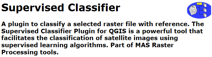

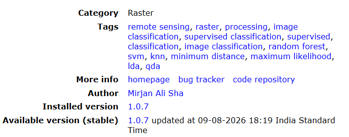

In QGIS, installed Supervised Classifier plugin for my image classification problem statement.
[cid:e5e491ca-e793-419b-8250-97b15293f7c7]
[cid:72c963ba-bc77-47a8-8fe5-c3337c71ccc1]
As I thought this plugin would be plug n play but encountered 2 issues:
