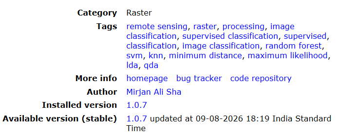

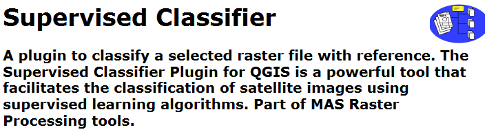

In QGIS, installed Supervised Classifier plugin for my image classification problem statement.
[cid:7c049d98-b193-4a7f-ae7f-aa581c098e59]
[cid:22e90dbc-ea0f-4873-838e-f52727d05a57]
As I thought this plugin would be plug n play but encountered 2 issues:
