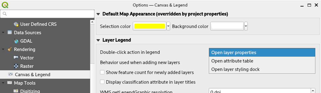

>> 1) change some default settings for QGIS Desktop
>> - e.g. left double click on layer to open attribute table for vector layers instead of opening properties (no other software that I used in my life opens properties on left double click), for raster layers it could do a zoom extents on raster (logic to open image on double click)
> This is a legitimate feature request, rather minimal, and that could be driven by a setting.  I don't agree that opening the attribute table is the only action that makes sense. Inkscape triggers a layer rename (F2) for instance. opening the attribute table for massive table is probably something you don't want to happen to easily. Not sure you will get a consensus for the default action, but having settings for this makes sense to me.
FYI: in Settings/Canvas & Legend, you can set yourself what the Double-click action is:
- Open layer properties
- Open attribute table
- Open layer styling dock
So you can set it to the second option to have your preference?
(see screenshot)
