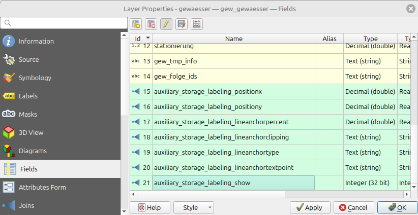

if their number is not too high, you can use the label-toolbar to hide
some of the unwanted labels manually:
Note:
QGis uses an "AuxiliaryLayer" attached to the labeled layer which stores
the feature-individual label-settings within the QGis-project:

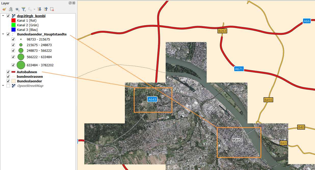

> Dear all,
> Is there a way to mark a raster as a block for other labels, as it is
> possible for vector layers? The raster is loaded as vrt and I don't
> want to show any labels in the area of the raster.
> I'm used to labels connected to the layer itself; therefore, if a
> raster is stacked above vector layers, it should overlay also the
> labels of all the layers lying underneath, but in QGIS the labels are
> all gathered in the top position.
> Thanks for any advice!
