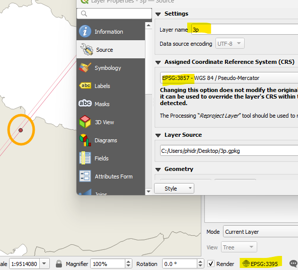

Hi Javier,
if I understood properly what you are trying to achieve - you want overlap
drawings (coordinates) from two coordinate systems as one image without
transformation - then you need to override "Assigned coordinate system"
(Right click on Layer -> Properties -> Source, and change Assigned
Coordinate Reference System.
That way QGIS will think that these two datasets are in the same coordinate
system and won't transform them "On the fly", otherwise it will reproject
all data to a coordinate system currently set in project properties - see
attached image.
