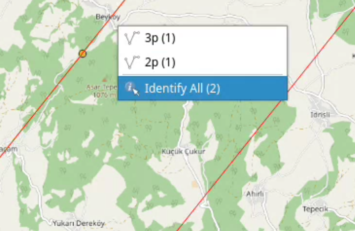

Only if I use the "Identify features", click in the area (at the proper
zoom level), and hover over "identify all" or "2p". Then a second line
appears! But it disappears when I select anything. (see attached screenshot)
