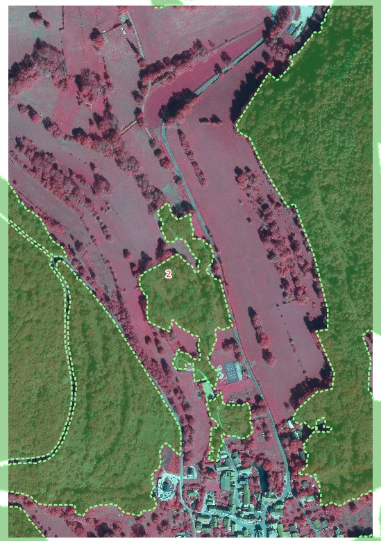

> Dear all,
> I'm working in a QGIS environment (graphical interface). Specifically, I'm
> using a QGIS modeler. Thanks to the processing toolbar provides, i have
> access to QGIS, Grass, Saga, and Orfeo toolbox tools algo. My goal is to
> generate a segmentation for geographic area. For the segmentation, I use
> the OTB tool via QGIS "Generic region merging":
> https://www.orfeo-toolbox.org/CookBook-7.0/Applications/app_GenericRegionMerging.html
> The complexity comes from the fact that I want to
> contextualize/differentiate the parameters and input data required for the
> segmentation step,within my study area based on a land use layer/mask
> layer. So i want to define specific parameters/input data for the
> segmentation generated on forest areas. And other input data/segmentation
> parameters generated for non-forest areas (urban, agricultural). I
> therefore have a vector data set, "Forest DB mask," which allows me to
> locate/mask forest areas.
> I therefore want to :
>    1. Generate an initial "raster segmentation" from an aerial/satellite
>    image with specific parameters for forest areas (segmentation calculation
>    only for raster pixels that overlap my forest DB mask). Therefore, the
>    calculation must NOT be performed/ be ignored for pixels not covered by
>    this mask layer (agricultural, urban, etc.).
>    2. Then generate a second "raster segmentation" for the rest of the
>    study area that was ignored/skiped during the first segmentation
>    (segmentation calculation only for raster pixels that do not overlap my
>    forest DB mask: agricultural, urban, etc.).
>    3. Then, once these two raster segmentations are complete, the idea is
>    to merge them into a single raster. Then, generate a polygonization (raster
>    to vector).
> This little workflow isn't really complicated. But I'm wondering if it's
> possible to do it in a QGIS modeling/graphical interface environment. I'd
> be interested in advice/ideas. Do I must to  clip input rasters with the
> forest DB masking layer? With a management/assignment of "no data values"
> to ignore the segmentation processing on areas not covered by the mask
> layer?
> I've attached below a screenshot that allows you to display an input
> raster image (here a multispectral Spot6/7 satellite image) and the mask
> layer (vector forest DB mask) to better visualize the context.
> [image: SS_MS_masque_bd_foret.jpg]
> Thanks so much.
