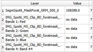

I would have a look at the masked raster and confirm the no data value
(-999) is written to the header so that it is recognized by the
segmentation routine. Another option would be to delete the segmented
polygons from your result layer (if your result is a vector) or using
the raster calculator to reset these pixels to -999.

> Following to my previous own post I'm taking the liberty to do a first
> reaction/addition. I tried clipping my multispectral SPOT6 image with
> my BD FORET mask (clip a raster with a masking extent coverage) by
> setting the value -999 (16-bit signed output) for the no data values
> during clipping.This worked. But when I try segmentation with the OTB
> GRM tool on this image, the process isn't ignored in the areas for
> which I had assigned no data values. The tool segmented the entire
> image. I sharean additional screenshot showing the pixel values in an
> area of no data values. The values are indeed set on no data values
> for the multispectral SPOT6 input image. And you can clearly see that
> it assigned a value to my segmentation result. The process has been
> done for no data values also :
> Thanks.

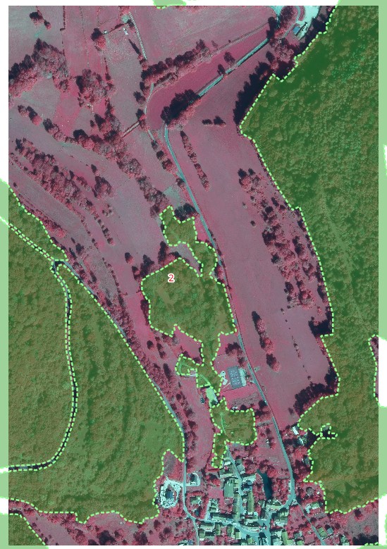

>     This little workflow isn't really complicated. But I'm wondering
>     if it's possible to do it in a QGIS modeling/graphical interface
>     environment. I'd be interested in advice/ideas. Do I must to  clip
>     input rasters with the forest DB masking layer? With a
>     management/assignment of "no data values" to ignore the
>     segmentation processing on areas not covered by the mask layer?
>     I've attached below a screenshot that allows you to display an
>     input raster image (here a multispectral Spot6/7 satellite image)
>     and the mask layer (vector forest DB mask) to better visualize the
>     context.
>     Thanks so much.
