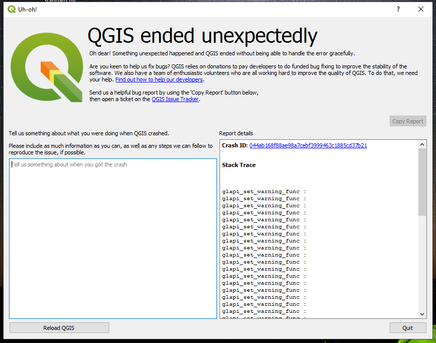

I Have this kind of issue.
[cid:image001.png at 01DBA21A.2F7EA540]

Hi Garry fox, That case sounds to me that you should file a ticket with VMWare, not with QGIS. Obviously the upgrade of VMWare introduced your issue. Also: do you just get an OpenGL error message or is QGIS failing to work inside the new VMWare?
Hi Garry fox,
Also: do you just get an OpenGL error message or is QGIS failing to work inside the new VMWare? Are you using anything OpenGL related inside QGIS?

Hi,
Good day!
I would like to raise a request regarding the compatibility test for QGIS 3.42.1. During testing, I encountered an issue related to a graphics driver or OpenGL error.
I am using a VMware device with VMware Tools version 12.5, and I found that the latest QGIS is not compatible with the latest version of VMware Tools. To resolve the issue, I downgraded VMware Tools, and that fixed it.Do you have any workaround or configuration to make the latest QGIS work with the latest VMware Tools?
