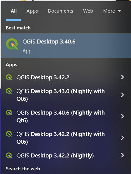

1. There are six versions of QGIS in my Windows Start Menu, and I don't
know which one to run.
- 3.40.6
- 3.42.2
- 3.42.2 (Nightly with Qt6)
- 3.42.2 (Nightly)
- 3.43.0 (Nightly with Qt6)
[image: image.png]
