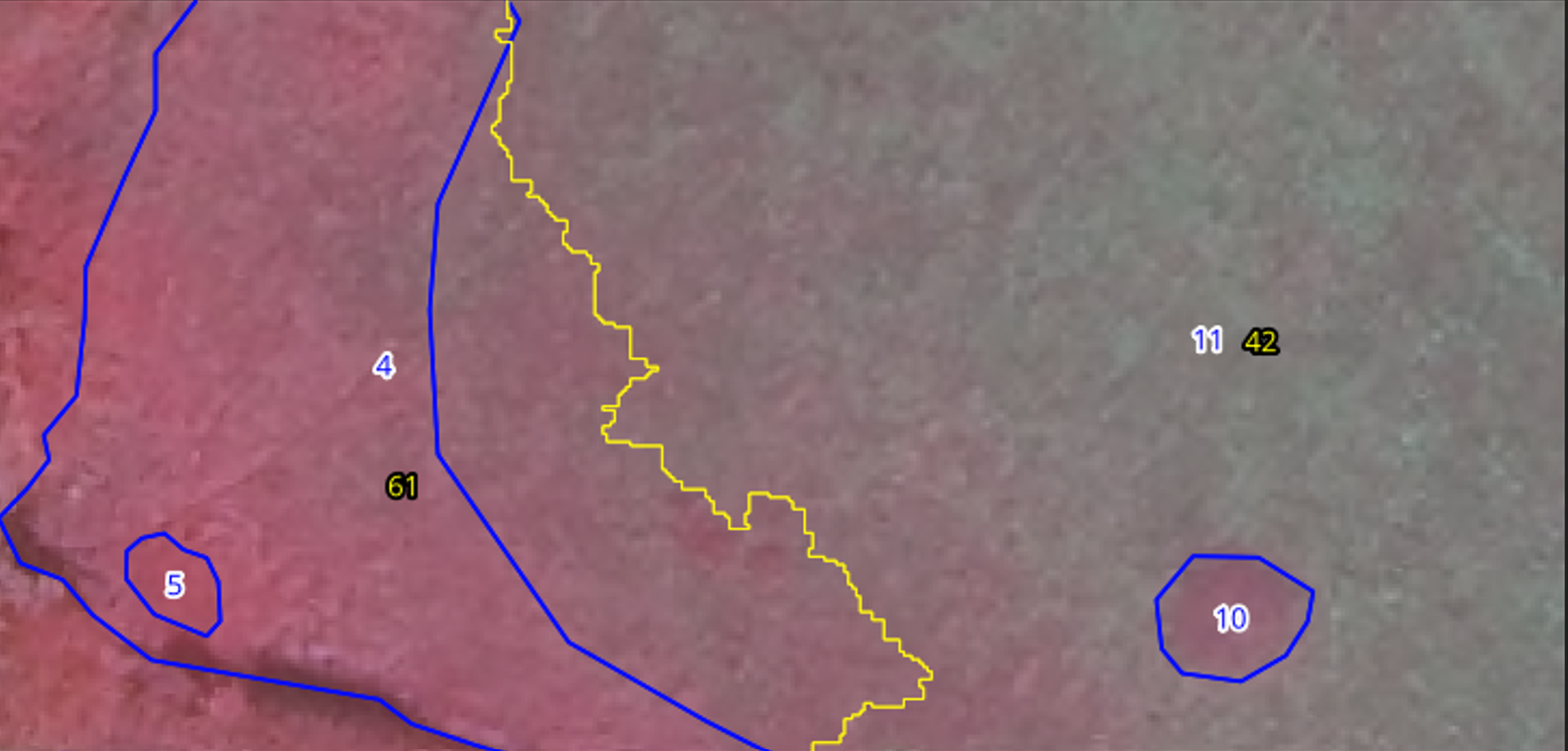

As a reminder, my goal is to find a method/tool to compare the
similarity/dissimilarity between two polygonal vector layers consisting of
multiple features. In my use case, this comparison concerns a polygonal
layer resulting from photo-interpretation work (modeling of large
physiognomic units/habitats). I reattached a screenshot; this layer appears
in blue.
The other polygonal vector layer is a polygonal vector layer resulting from
a segmentation process (using an OTB tool available via QGIS). (It is
yellow in the attached screenshot):
[image: image.png]
In my previous post, I mentioned a possible way for one similarity
indicator: "for each photo-interpreted feature/polygon, calculate the
percentage (%) of area covered by the feature from the segmentation layer
that has the highest overlap."
To be more specific, in the example in the screenshot, it could be:
"for feature number 11 (blue) from the photo-interpretation layer, I would
like to know the proportion of the area covered by the feature from the
segmentation layer that has the highest overlap with this feature 11 (in
this specific case, it is probably feature 42 in yellow)."
This could be: area of feature 42 overlapping with feature 11 / total area
of feature 11.
