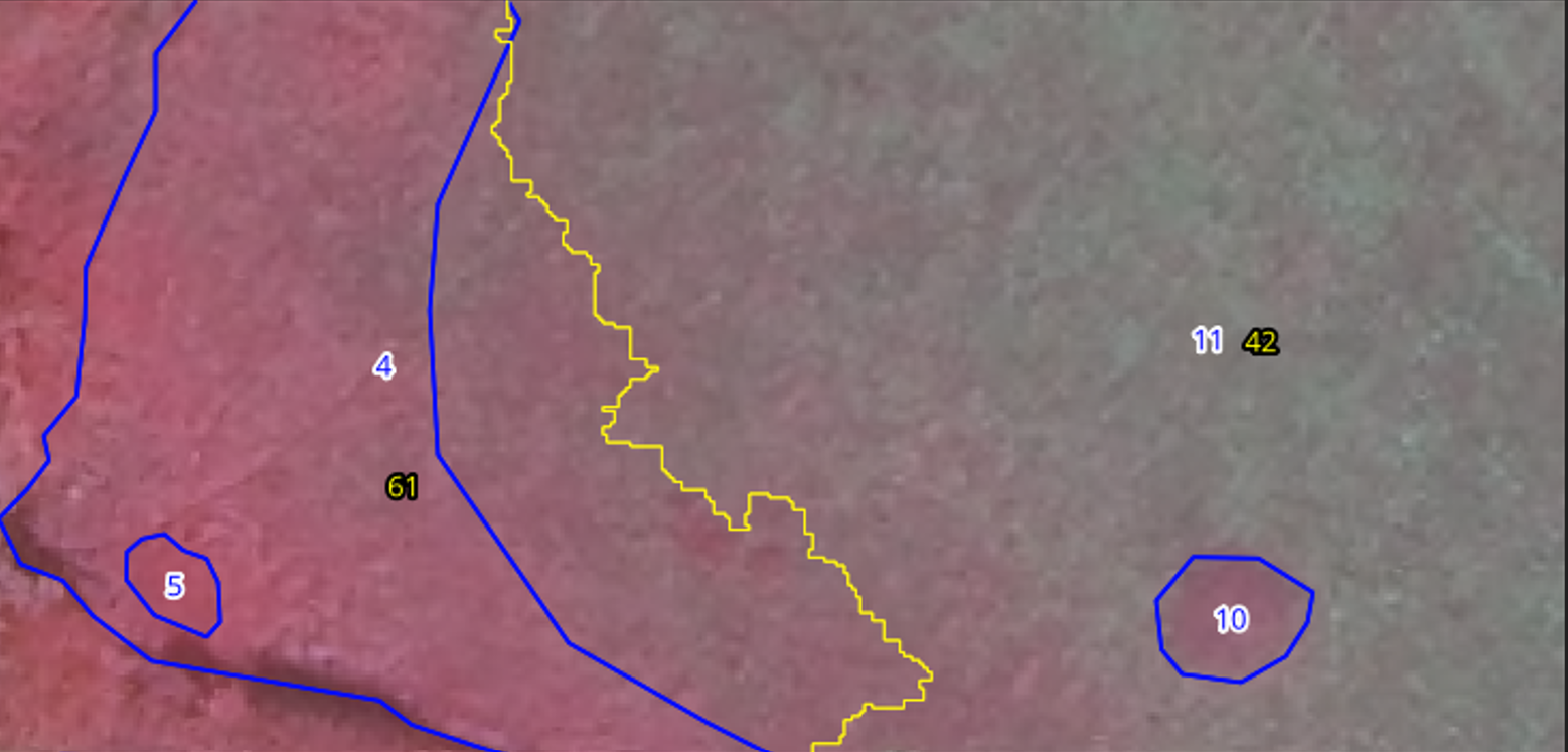

> As a reminder, my goal is to find a method/tool to compare the
> similarity/dissimilarity between two polygonal vector layers consisting of
> multiple features. In my use case, this comparison concerns a polygonal
> layer resulting from photo-interpretation work (modeling of large
> physiognomic units/habitats). I reattached a screenshot; this layer appears
> in blue.
> The other polygonal vector layer is a polygonal vector layer resulting
> from a segmentation process (using an OTB tool available via QGIS). (It is
> yellow in the attached screenshot):
> [image: image.png]
> In my previous post, I mentioned a possible way for one similarity
> indicator: "for each photo-interpreted feature/polygon, calculate the
> percentage (%) of area covered by the feature from the segmentation layer
> that has the highest overlap."
> To be more specific, in the example in the screenshot, it could be:
> "for feature number 11 (blue) from the photo-interpretation layer, I would
> like to know the proportion of the area covered by the feature from the
> segmentation layer that has the highest overlap with this feature 11 (in
> this specific case, it is probably feature 42 in yellow)."
> This could be: area of feature 42 overlapping with feature 11 / total area
> of feature 11.

If you look at your three steps above, the numerator is always the same -
the surface area of feature 42 overlapping with feature 11.  In PostGIS you
will want the area of the intersection, something like this:
SELECT ...,ST_Area(ST_Intersection(interp.geom,segment.geom) as overlap
FROM ...
You can read about these two predicates here:
https://postgis.net/docs/ST_Intersection.html
https://postgis.net/docs/ST_Area.html
In your WHERE clause you can use ST_Intersects() to narrow your search to
all polygons that intersect with each other, something like
WHERE ST_Intersects(interp.geom,segment.geom) ...
Read about that here:
Along with that core, you can add the total surface area of the interpreted
and segmented layers to the SELECT clause, something like:
overlap_area, ST_Area(interp.geom) as interpreted_area,
ST_Area(segment.geom) segmented_area, (ST_Area(interp.geom) +
ST_Area(segment.geom)) as total_area FROM ...
You can also use division in the expressions in the SELECT clause to do
your division for you, something like
(ST_Area(ST_Intersection(interp.geom,segment.geom) / ST_Area(interp.geom))
as step1_area
If you're going to do division, it's always good practice to guard against
divide-by-zero using a CASE expression, something like:
CASE WHEN ST_Area(interp.geom) = 0 THEN 0 ELSE
END as step1_area, ...
> * Step 3:*
> The idea would be, based on steps 1/2, to have a kind of overall score at
> the layer level. This could be a kind of average/median for all pairs of
> polygons? Or another metric?
Why not just report all three and decide what you want later?
Alternatively you can take the remote sensing kind of approach:
https://gsp.humboldt.edu/olm/courses/GSP_216/lessons/accuracy/metrics.html
