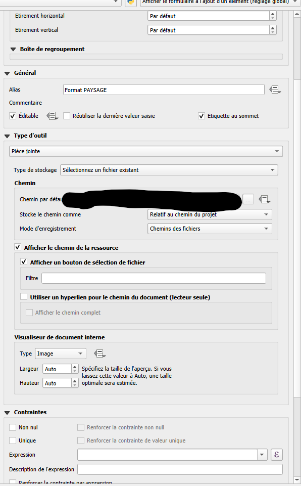

I have tried to "play" with the parameter for this form attached tool, (as
for example relative/absolute path size of the images, etc.). But in vain.
Have people ever been confronted with this problem/limitation/problem of
table opeining performance regarding the attribute form design? Linking
with attached tool for image/picture ?
For information, a SS of the interface :
[image: image.png]
